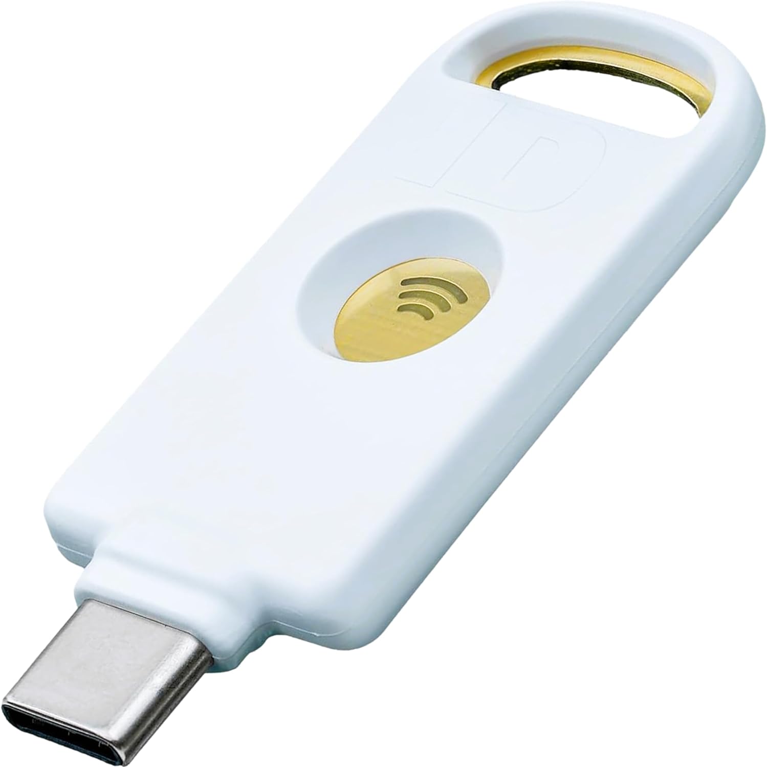

I’ve found this $19.50 one which is Level 1 certified, and it’s name-brand:
At a glance, I can’t find any that are significantly cheaper than this on Amazon, if you know of any $10-$15 let me know. I also can’t find any that are the same price as this one and have NFC. This Identiv one looks like a good candidate to list, actually.
