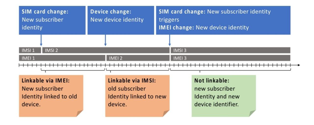

Changing IMEI will help you ONLY if you change IMSI too (see image in my post above). To change IMSI you need to change SIM.
I use this feature to prevent cellular providers from cross tracking me between networks.
In this case go with blue-merle

Generally, you need to swap IMEI only when you change SIM (eg new number, travel SIM etc). In other cases it won’t help too much.
For FULL anonymity you will need disposable SIM (better for 1 session), disposable IMEI and Tor browser. But I don’t think anyone here needs soo much anonymity.
