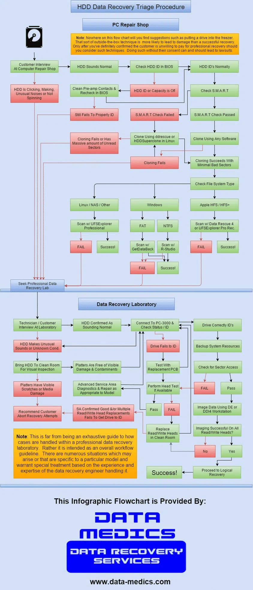

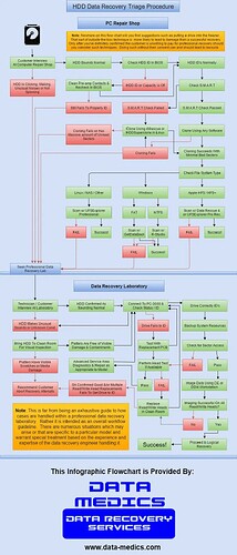

Last time I had this issue, I went to a local computer repair shop. They have expertise and the equipment to do this right. I didn’t want to further brick my stuff myself doing the wrong thing by mistake.
Maybe try this:
Unfortunately not an option in my city. I could send it to another, but I haven’t decided on that yet. I also don’t want anyone else to see the data, so there’s that too

If your HDD is still showing up in Disk Management, that’s actually a good sign and means it might not be completely dead yet. Drives that don’t initialize can sometimes still be accessed with the right tools, especially if the issue is more logical than physical. I would avoid trying to format or reinitialize it for now, as that can overwrite data. There are quite a few tools out there, and you can check this best data recovery software which gives a decent overview of options. Some programs can scan the drive even if it’s not fully accessible and recover files from it. Just make sure you install any recovery tool on a different drive, not the one you’re trying to recover. Also, be patient because scans can take a long time depending on the size of the HDD. If it doesnt work, you maybe need to look into professional recovery services.
