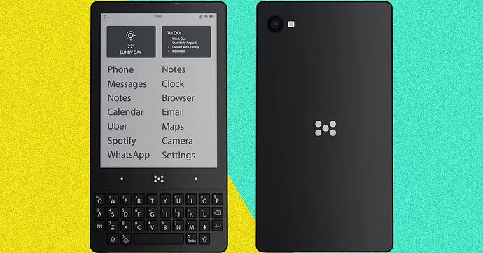

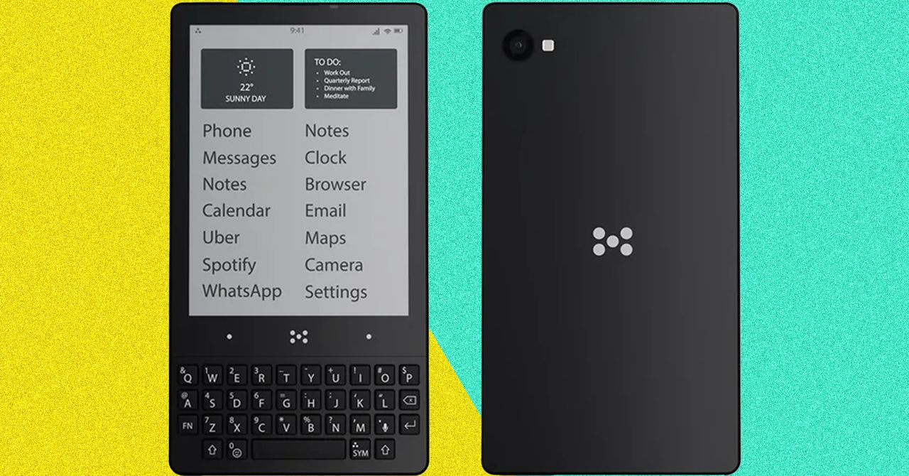

From Braving, there is a phone called the minimal phone that is currently on Android 14, and they pledge 5 years of software update. This is a new company.
