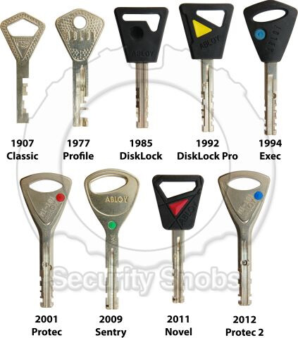

Here in Finland lock picking of apartments is a negligible issue thanks to Abloy, whose locks are on (according to YLE) 90% of our doors. Most locks use Exec cores from what I’ve observed.
Abloy doesn’t really downgrade its lock designs and AFAIK there haven’t been blunders so the per-year designs should reflect security tiers (although Novel might make an exception I don’t know about that one).

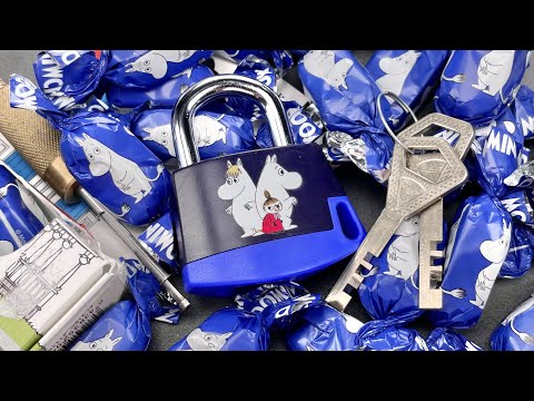

As you can see they’re all disc tumbler locks, and even the 120 year old classic core with minimum number of discs, embedded in a plastic Moomin lock, gave LPL some exercise:
So go with Exec or Protec(2) and there’s only a handful of people in the entire world who know how to pick one and who have the necessary specialized tools.
