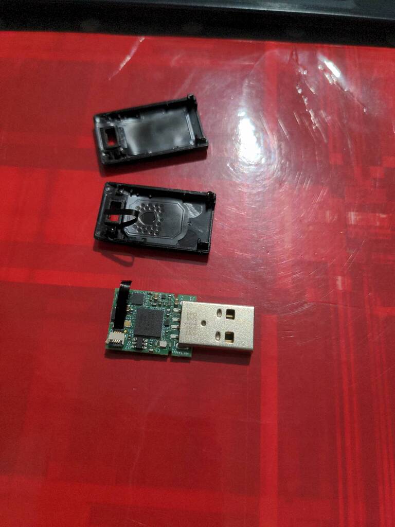

I have the same question, they’re far from being the best option while being proprietary and blocking firmware upgrades.
It shouldn’t be this easy to open and get access to the internals, so tampering is a huge concern.

Good luck tampering with YubiKey or OnlyKey at all, let alone leaving no signs of tampering. This is just a downside that is worth pointing out, if you care about it depends on your threat model.
As for equipment, I will leave it up to you to decide if $3000 in equipment is expensive or not.
