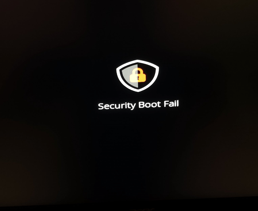

Recenty i bought a laptop called acer swift go and i have plan to install linux on that but i find many issues mainly secureboot
I cant boot fedora or ubuntu with secure boot turned on i hope this community have many users who have a deep knowledge about if they could help.
This is the error

If you’re trying to install Linux on a computer with Secure Boot on, it won’t work. You need to disable Secure Boot before installing your preferred Linux distribution. Afterwards, you can reenable it in BIOS.
If anything, it is a good thing that it failed since that is the entire point of Secure Boot. Just don’t forget to turn it back on afterwards :slight_smile:

Oh my bad. That hasn’t been a concern for some distributions recently. To correct myself, it really depends on a bunch of other factors that could make secure boot not work
No not true i have other device where i can boot live with a fedora media without turning off secure boot i can easily use fedora on that…
@brivacy what did you use to create the installer, the official Fedora Media Creation Tool, or some third-party disk writing software?
I have used fedora media writer from fedora first make a ubuntu bootable
Next with Rufus in windows fedora workstation bootable with iso and next in dd more both in gpt and mbr mode but does not work show me that error…

What they said in the Fedora forum is also what I am thinking.
This sounds like the signing keys in bios are not what are expected by the OS so the system will not load the kernel with secure boot.
You might be able to use that “Select an UEFI file as trusted for executing” option in your BIOS to get past this.
Unfortunately I’m not familiar enough with Acer to know much more than this. Everything with Linux “should” work with secure boot in theory these days, but many individual manufacturers have buggy UEFIs and secure boot implementations that can make it a bit of a crap shoot. Worst case you can try installing without secure boot and then enabling secure boot after installation, which isn’t ideal but sometimes necessary.

I have an SFG14-72 and installed Fedora on it.
In the UEFI in the “Security” tab you can “Select an UEFI file as trusted for executing” and Secure Boot shouldn’t complain.

Which file i need to select… Can you help.
