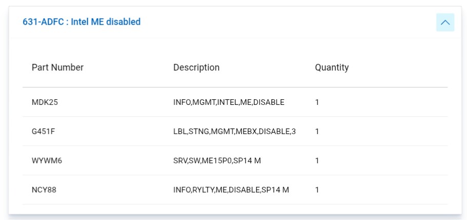

Hello, I have a question about a Dell laptop. It has an i7-1265U processor, which includes vPro Enterprise in its specifications, but I have a standard Intel sticker on the laptop. I checked this laptop on the Dell site using its service tag, and under specifications, there is an entry: “631-ADFC: Intel ME Disabled.” I searched the internet for this, but there isnt a lot information about it. I think it only disables the Intel AMT function because, in the UEFI settings, I dont see any Intel AMT-related options, and Ctrl+P during startup doesnt work either, though Intel TXT and TME are present. Does anyone know what “Intel ME Disabled” means and exactly what is being disabled? Thanks for your help.
You can start by providing the actual laptop model first.
