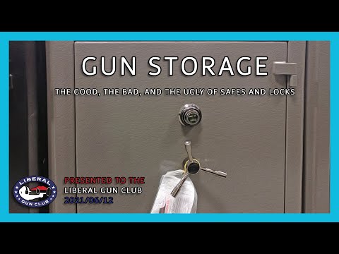

I’d recommend Deviant Ollam’s gun safe video. It is gun safe specific, but he goes into a lot of detail about what generally makes a safe “good”. I don’t know where you are but a lot of safes sold in the US don’t even meet the basic UL requirements to be classified as a safe. Most of them are “residential security containers”.

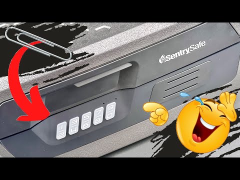

I just don’t want the safe to have stupid design flaws like these:
If one needs special skills and/or tools to unlock the safe, then it’s good enough for me.
TBH there are no cheap safes without design flaws.
