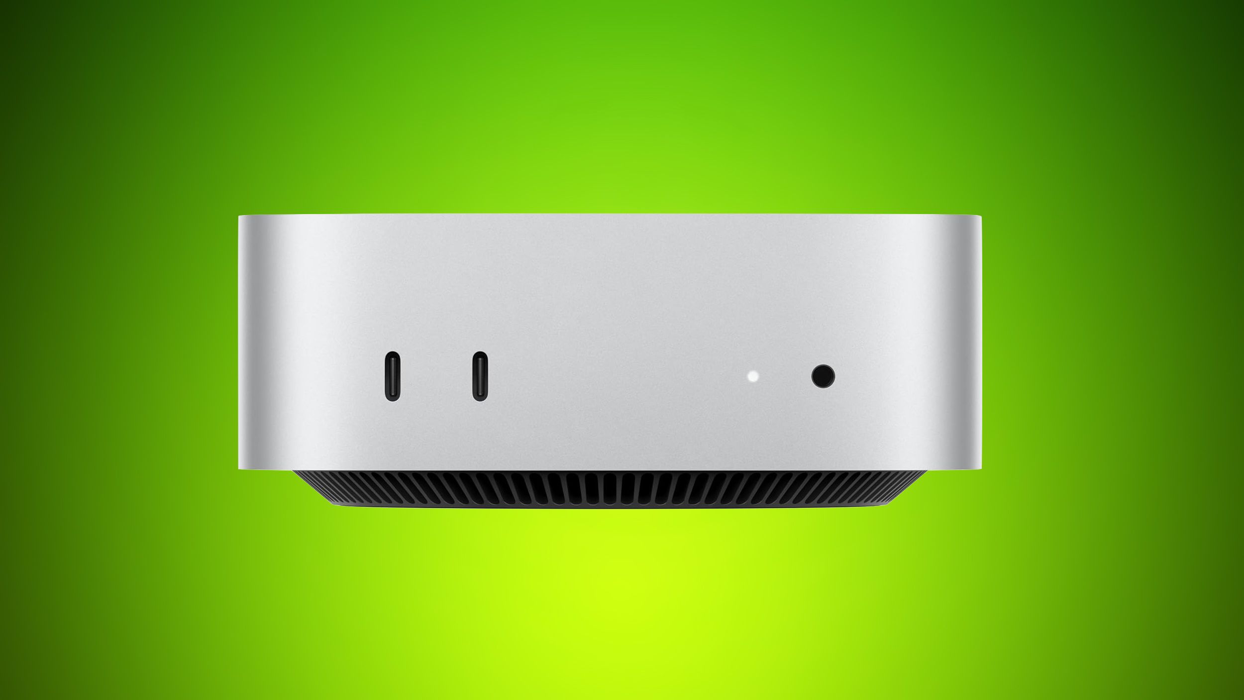

Question is affordability. Look at how fast people are snapping up Mac Minis.

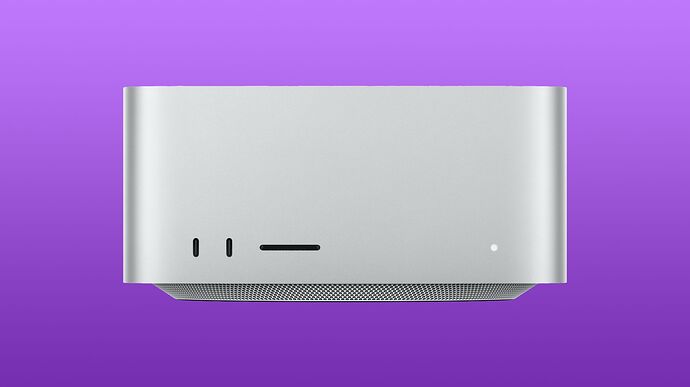

Mac mini probably wouldn’t be sufficient as the most you can get now is 48GB (and paying a premium for that). You’d probably need a studio and the answer is very expensive.
Also in terms of stack, a lot of these models/toolsets are on a more mature Linux stack, (that’s whats also going to be running in a datacenter) so if you’re self hosting I wouldn’t be buying a mac for that. Essentially Linux support on macs sucks, and won’t ever be good because of the distinctly different hardware, and you’re at Apple’s mercy for support for however long that is.
