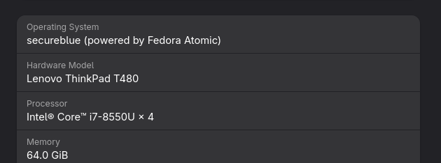

The i7-8650U only supports up to 32 GB of DDR4 RAM @ 2400 Mhz:
No I have a maxed out T480 it supports 64gb I use it for testing Secureblue and QubesOS.

Okay, does it support any other higher RAM configurations (2 x 48 GB or 2 x 64 GB)? How exactly can it support over 32 GB to begin with?
64 GB is max. Gen 8 CPU was the first to support 64GB. It says 32GB because 32GB sticks didn’t exist when the T480 was released. :slight_smile:
