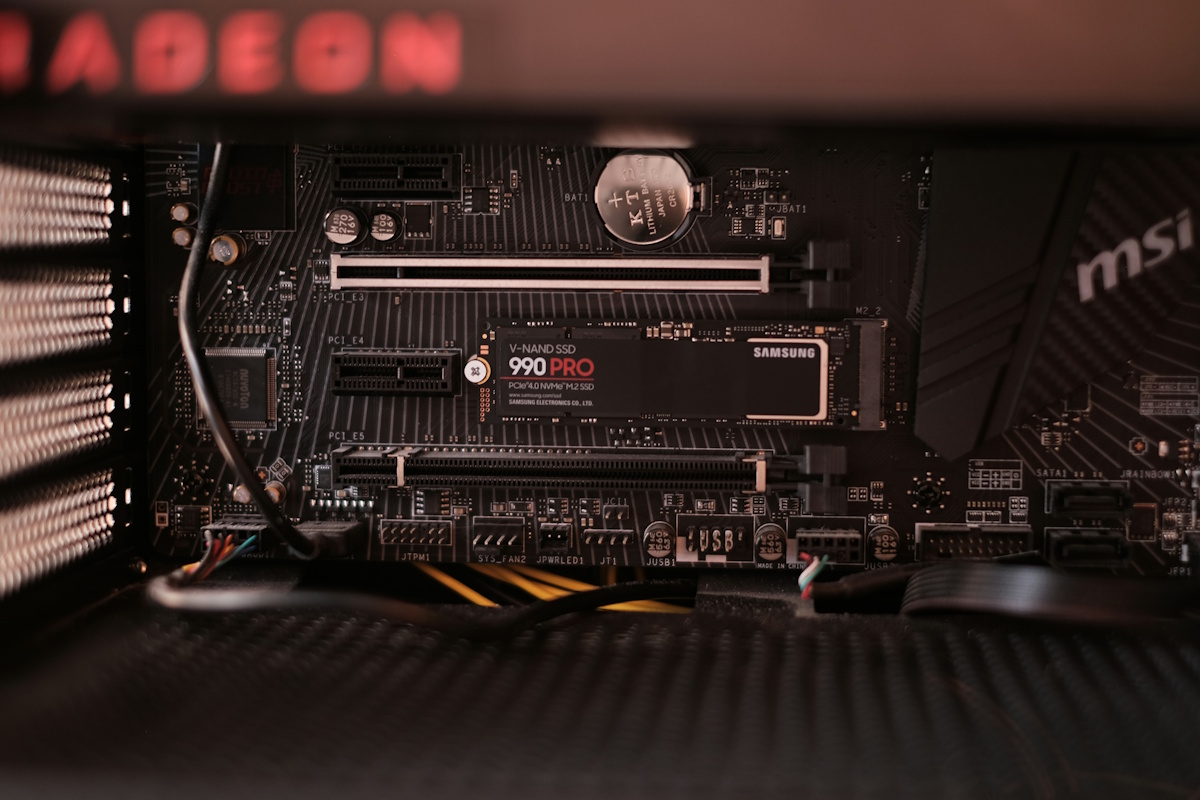

Had me worried about my dual Samsung 990 PRO(4TB) drives that cost like 700 dollars for the pair at the time I bought them.
