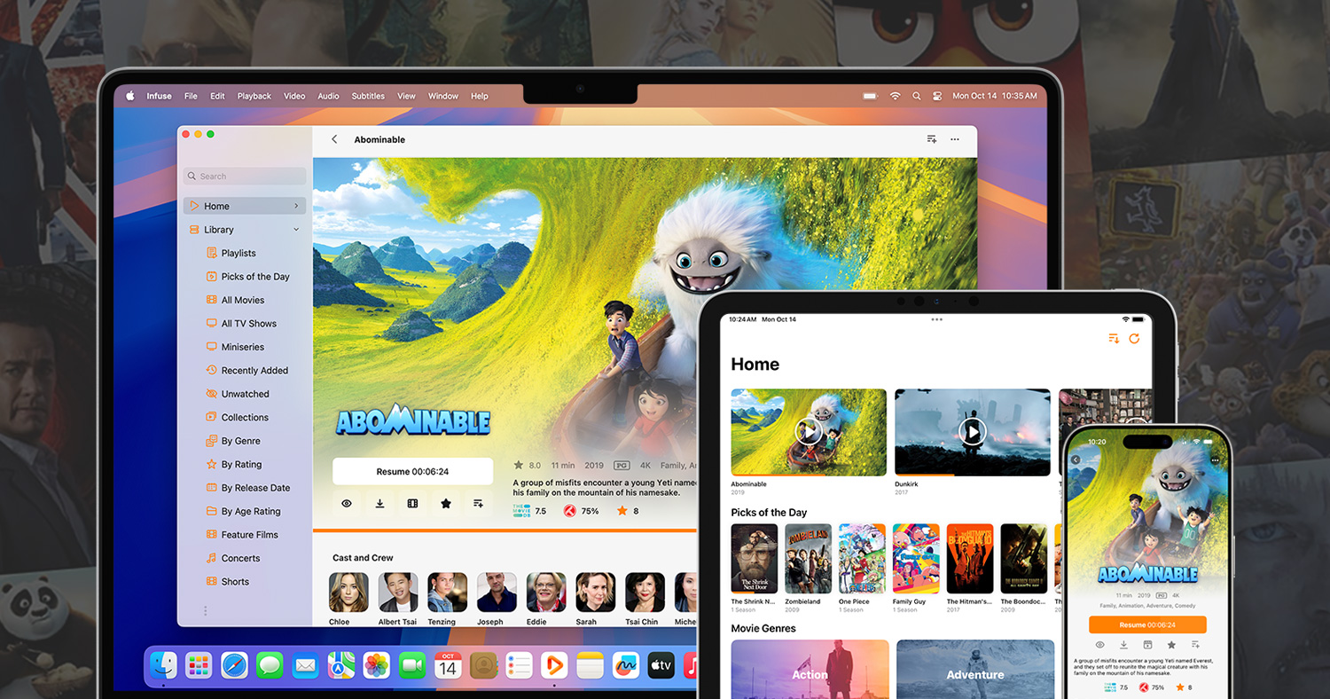

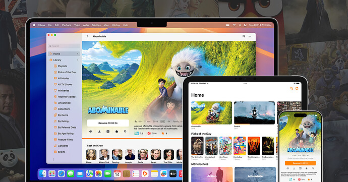

I originally got this as a response on the Techlore forum.
They self host the videos on a seperate device (they use a Jellyfin setup) and stream to the Infuse Video Player locally. Which offers something that’s a bit more setup and forget.
