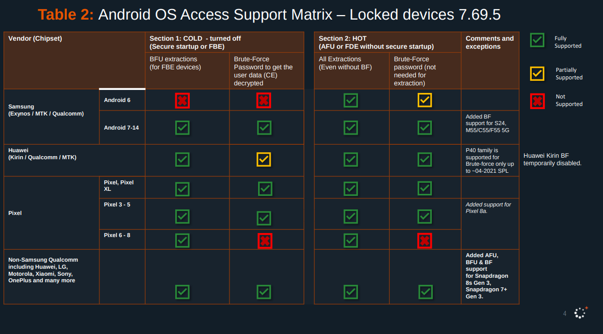

Here’s the Cellebrite Premium 7.69.5 Android Support Matrix from July 2024 for Pixels. They’re still unable to exploit locked GrapheneOS devices unless they’re missing patches from 2022. A locked GrapheneOS device also automatically gets back to BFU from AFU after 18h by default.
GrapheneOS is defending against these tools with generic exploit protections rather than by patching specific vulnerabilities. Until recently, it’s likely that it was our generic memory corruption exploit mitigations including hardened_malloc which was successfully stopping this.
In February 2024, we added a new feature for disabling the USB-C port at a hardware level. In March 2024, we set the default mode to “Charging-only when locked, except before first unlock”. In June 2024, we increased the default security level to “Charging-only when locked”.
Later in June 2024, we extended our software-level USB protection, merged it into the newer hardware-level protection feature and extended the hardware-level protection to pogo pins on the Pixel Tablet. There’s extremely strong protection against these USB-based attacks now.
Here’s the Cellebrite Premium 7.69.5 Android Support Matrix from July 2024 for overall Android devices. Other than the Titan M2 on the Pixel 6 and later not being successfully yet to bypass brute force protection, it’s largely just based on what they’ve had time to support.

Glossary:
BFU: Before First Unlock exploitation of OS
BF: Brute Force password after BFU exploitation, which requires bypassing secure element brute force protection if implemented
AFU: After First Unlock exploitation of OS
FFS: Full Filesystem Extraction from an unlocked device
read the linked comment
BFU refers to exploiting a device Before First Unlock. BF refers to whether they can brute force lock methods after BFU exploits., which they cannot for Pixel 6 or later / iPhone 12 or later due to the more hardened secure elements. AFU refers to exploiting a device After First Unlock, which obtains access to nearly all the data.
Does Samsung Autoblock feature protect from Cellebrite?
No.
I see that non-samsung mtk are in yellow and not in green, does it mean now Mediatek are safer than Qualcomm against cellebrite?
No. They just put less resources into MTK devices. Most phones that have Mediatek chips have lots of other flaws they can use.
