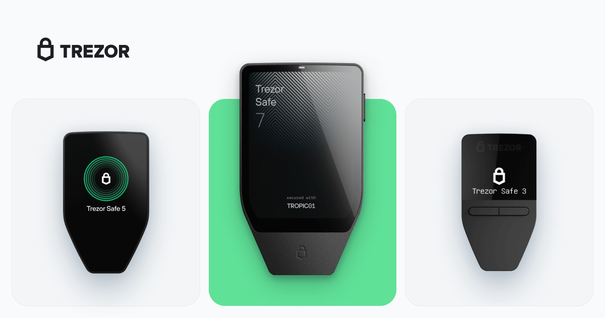

Open-source hardware cold wallets for storing cryptocurrency securely.
Privacy Guides recommends Monero, and so I believe a hardware cold-wallet recommendation makes sense to complement that recommendation. Modern Trezor wallets are, as far as I know, the best option in this category. They are open-source with EAL6+ certified secure elements to protect private key material. They can also be used with the official Monero GUI / CLI rather than Trezor’s own Trezor Suite.

Do we have opinions on whether the TROPIC01 chip in the upcoming Trezor Safe 7 is enough of a security upgrade to no longer suggest using the Safe 3 and 5?
I think it is probably not, and we should recommend all 3, but I’m curious if anyone has an opposing viewpoint.
I don’t think so. It’s very new and lacks any EAL certification, which is probably why they chose to go with a dual-SE architecture. Personally, I think the TROPIC01 is more exciting for how accessible it could make cutting-edge secure elements.
Tropic01 really, in the Trezor Safe 7 it’s not a huge deal since there is still the OPTIGA secure element, but then your effective security is the same as the Trezor Safe 3/5 leaving no reason to spend almost 2× as much on the Safe 7.
Where it would be more impactful would be any product where you only have one secure element, like anywhere you need a hardware root of trust, such as for IoT devices. Unfortunately, but perhaps unsurprisingly, having only just released their first product, Tropic Square are in my opinion not yet established enough to prove they have what it takes to build robust secure elements that stand up to intrusion attempts over time (like the Titan M2 for instance).
Thus I never said they should stop selling the Safe 7, but all their marketing is based on the Tropic01 being necessary because closed-source secure elements can’t be trusted when in fact the opposite is true in this case. There is at this time no reason to spend nearly 2× as much for the Safe 7 over the Safe 5.
iOS compatibility.
One reason then. They haven’t even bothered to add FIDO2 support over Bluetooth despite the Safe 7 being the first Trezor devices with Bluetooth.
Honestly FIDO2 over Bluetooth seems kind of dead, but the Safe 7 also has unused NFC hardware they could’ve used for this purpose too. Missed opportunity, but I suppose they still could add it at any time.
