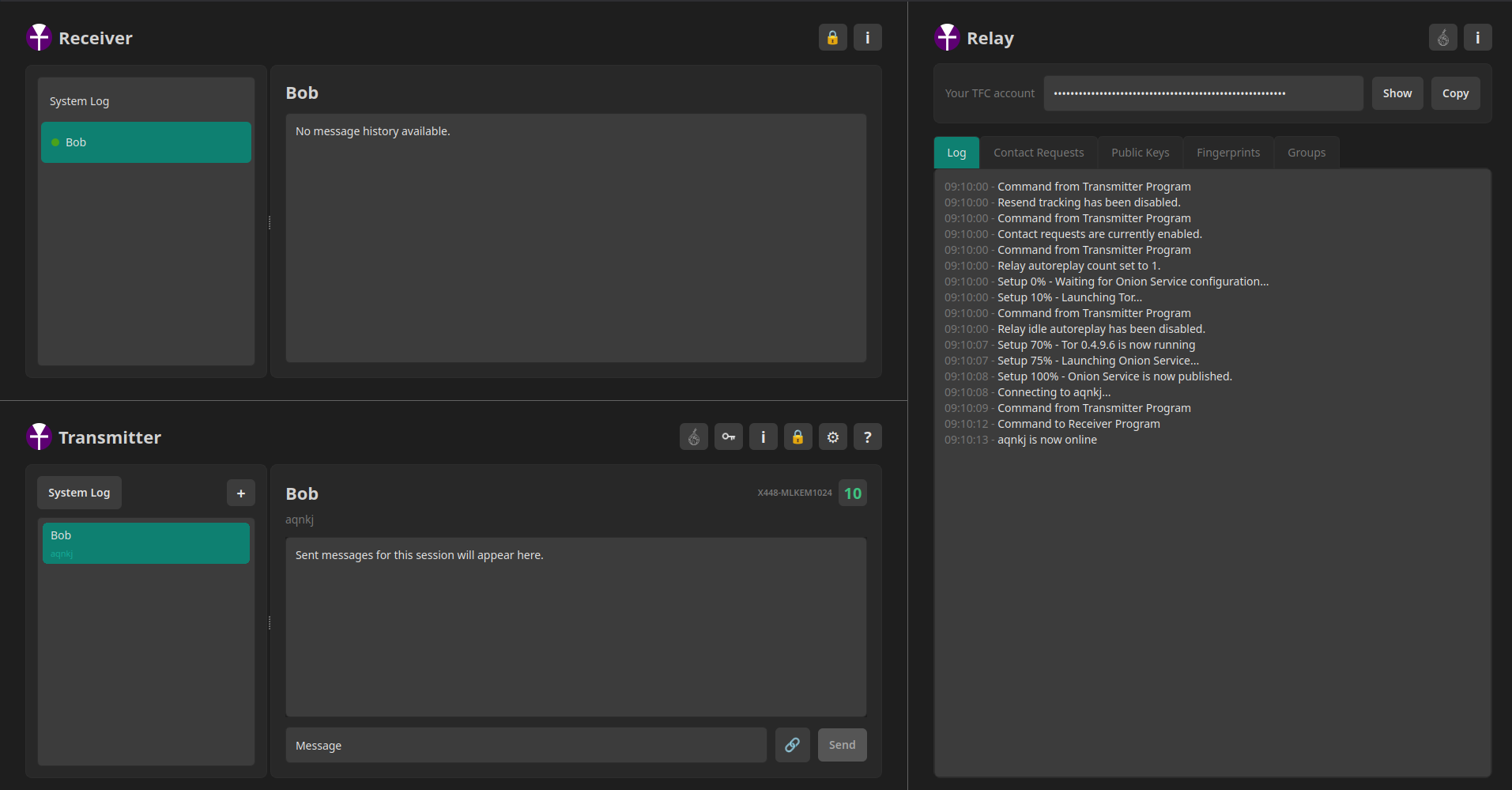

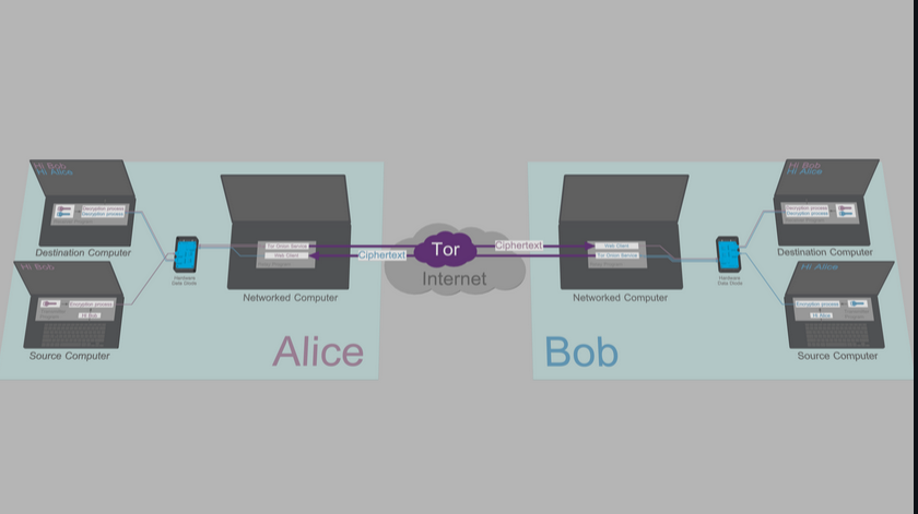

The endpoint security is provided by separating the user’s messaging endpoint into three separate programs, run on three separate computers.
- The text input window / message encryption and ciphertext output are handled by
Transmitter ProgramonSource Computer - The ciphertext input, message decryption and conversation window are handled by
Receiver ProgramonDestination Computer
These two computers are dedicated for TFC and form the so called split TCB. TCB stands for Trusted Computing Base, and is defined as the smallest set of a system that needs to be secure for the system to be secure.
The two communicate with user’s daily computer we call Networked Computer that exchanges ciphertexts with other peers with program called Relay Program.
Here’s the general layout of the system:

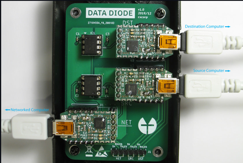

Data diodes
The three computers communicate through something called a data diode, that allows moving data between two computers in one way only. Data diodes are nothing new, they’ve existed about since the 1980s. TFC is just the first (at least the first unclassified) tool to use two of them for secure communication.
Data diode has very little to do with standard diode (the electrical component). It doesn’t move electricity in one way. Instead, data diode operates on optics, you have LED as a lamp, and photodiode as a lamp detector, and the same way your ear can’t speak and my mouth can’t listen, the fundamental limitations of these components enforce the direction of data transmission. Photo diode and LED are both diodes but the optical gap means there’s no electrons being exchanged by the hardware. This makes it possible to e.g. galvanically isolate the Source and Destination computer by running them on battery-equipped laptops.
This is the most misunderstood part of the project so I’ll emphasize upfront, that the data diode does not encrypt, change, monitor, validate, or in any other way process or store data. It only makes sure that the ones and zeroes can be sent from one device to another in one direction only.
TFC uses two data diodes, but for convenience both are placed on the same circuit board, whether its breadboard, perfboard, or PCB. Each computer connects to the data diode with a USB cable, and on the data diode’s end, the USB-cable terminates into a USB-to-TTL adapter, which converts the USB signal into old-school dead simple serial traffic at TTL voltages (high = 3.3/5V, low = 0V). The serial signals are then fed through HCPL-7723 optocouplers that house the optical repeater. These components are generally used to send control signals to high voltage electronics while protecting the sending side from voltage spikes. You can find them e.g. in your washing machine’s controller circuit board. TFC repurposes the component for endpoint secure communication.
Here’s the PCB data diode for reference:

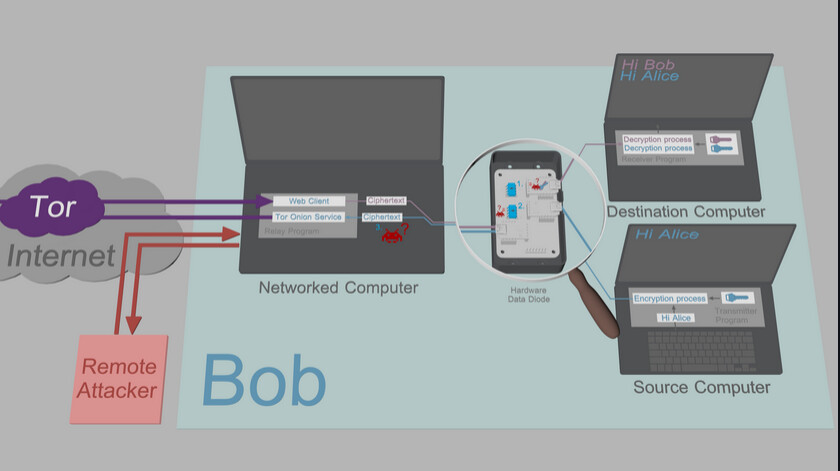

Key exfiltration security
Key exfiltration protection comes from the fact that plaintexts, keys, and cryptographic operations are handled only on Source and Destination computers, and neither computer has bidirectional communications channel to the network. This means that
- The Source Computer can’t receive malware that would make it export sensitive keys/plaintexts.
- The Destination Computer can in theory receive malware, but that malware has no channel it can use to send the keys or plaintexts out.
- The Networked Computer has only access to ciphertexts and public keys.
