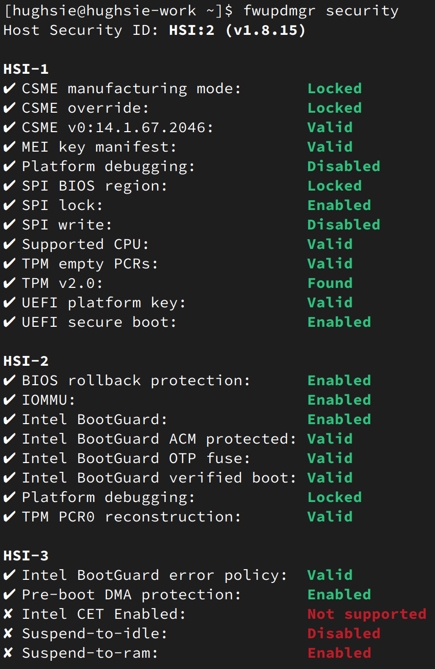

You can see where your device is weak against when you run fwupdmgr security. Also yes, you can keep your firmware up to date with this but some vendors do not use this method for some of their consumer motherboards.
You want a HSI:4 but that seems to require specific Intel vPro or Ryzen PRO CPU. So we aim for a HSI:3 level of security for the rest of us.
This screenshot one below has HSI:2
You can also see this Fedora 40 via GNOME Settings >>> Privacy & Security >>> Device Security like this HSI:0 score that I have :sweat_smile:
