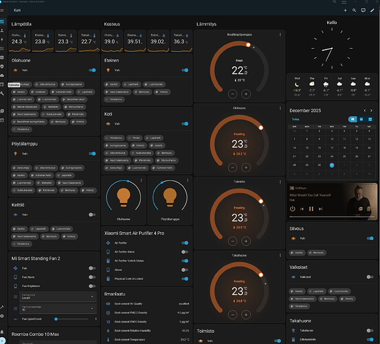

Just started messing with themes. These iOS-like ones are looking pretty sweet to me.
