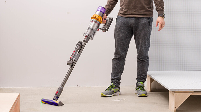

Idk, I’m a sucker for a good ol’ manual Dyson v15 (whatever the model with the accessories)
Just works, simple, practical and warranty works fine too in case of any problem (just don’t drop it + don’t let it suck water :ocean:).
