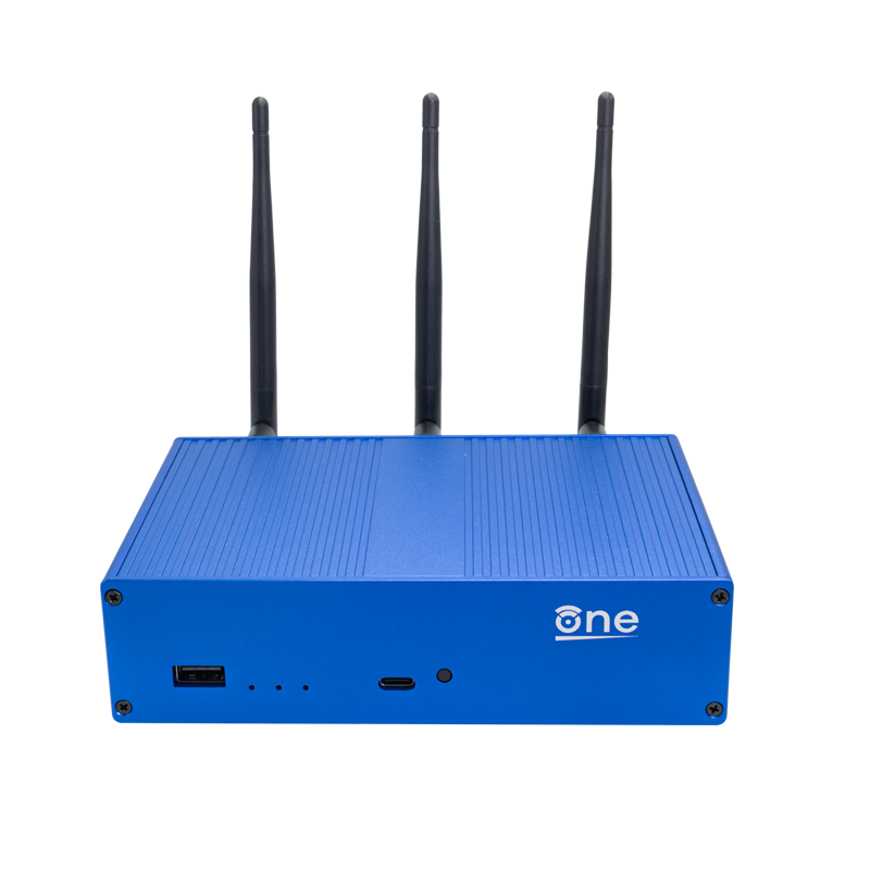

As for the router, if you just want something simple and don’t have many specific requirements, I would just go with the OpenWrt One. It’s the official router of OpenWrt and will work very well with it.
I second this for an easy solution that works out-of-the-box
