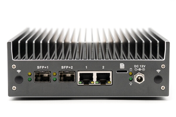

Protectli Vault (Pro) can utilize Secure or Measured Boot:
Based on an example test result from 3mdeb targeting the Protectli VP6670 for their latest Dasharo Coreboot firmware release on June 6th, 2025, UEFI Secure Boot is supported for both Ubuntu and Windows (#L105 and #L106), while Measured Boot, also known as verified boot, is supported for Ubuntu (#L75):
