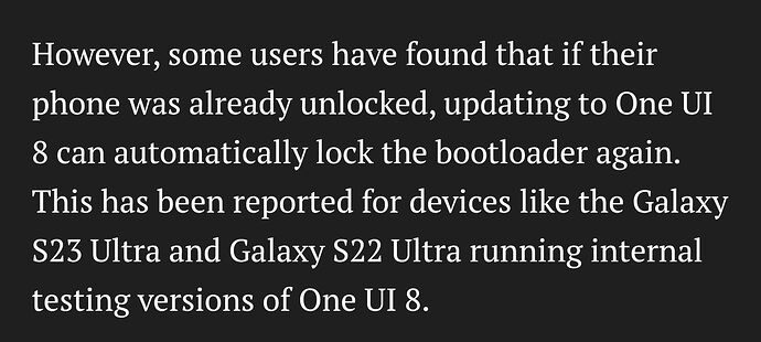

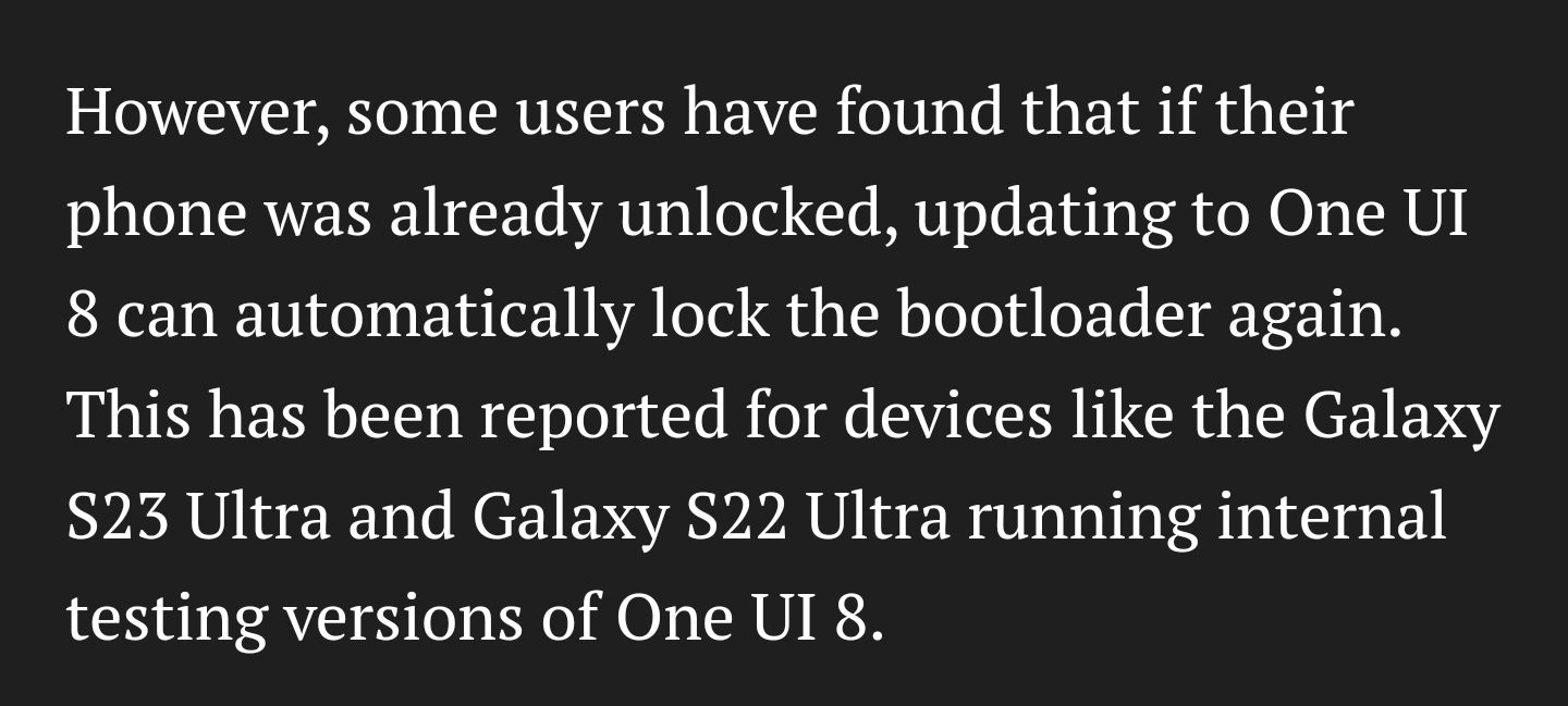

just keep in mind that it seems that One UI 8 is blocking OEM Unlocking:
Sources
General - Bootloader unlocking option removed from One UI 8.0 | XDA Forums
https://safereddit.com/r/Android/comments/1mabuht/samsung_removes_bootloader_unlocking_with_one_ui_8/
One UI 8 removes bootloader unlock from Samsung Galaxy
Samsung may be killing bootloader unlocking on all phones with One UI 8
Samsung One UI 8 beta removes OEM unlock toggle
Say goodbye to your custom ROMs as One UI 8 kills bootloader unlock - SamMobile
https://www.gadgets360.com/mobiles/news/one-ui-8-bootloader-oem-unlocking-disabled-galaxy-z-flip-samsung-report-8963760
Breaking - Samsung Removes Bootloader Unlocking with One UI 8 - SammyGuru
Samsung Deletes 'OEM Unlocking' From the One UI 8.0 Developer Options - The Tech Outlook
One UI 8 spells the end for custom ROMs on Samsung phones
Samsung's One UI 8 update is about to tick off the custom ROM crowd | Android Central
If you are in One UI 8, it is unfortunate and you’re stuck, unless you figure out reverting among other things.
