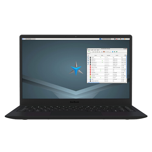

If you are specifically looking for Qubes OS compatibility, the StarBook Mk V is Qubes-certified, although it is now discontinued and succeeded by Mk VI:
