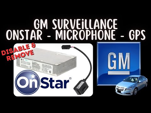

Lets say a vehicle has on star tracking. You can: disable the service from the screen, then remove the fuse for the onstar, then remove the whole onstar box, remove the microphone.
If you want a demonstration of how to disable tracking within 10 seconds, watch the national geographic documentary “trafficked” special on car theft. A car thief calls his friend, who tells him the location of the 3 antennas on the vehicle and he quickly pops them all out.
Note, if you financed your car, its possible the dealership installed a secondary (third party) tracker that is hardwired into your car somewhere. You can find these and cut them out too.
