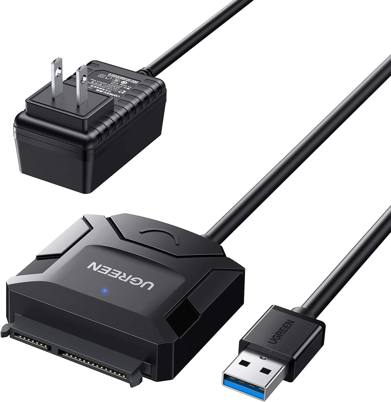

My suggestion would be not to buy an external HDD. Instead, buy a regular (internal) HDD or SSD and a SATA to USB adapter. This gives you more flexibility in how the disk can be used, and similar USB adapters exist for NVME too.
This is a good suggestion.
I will add to it however: make sure you get a USB 3.2 Gen 2 (10Gbps) enclosure even if you don’t need it. Why? Because the controllers in most of the older/slower models are awful and don’t handle things like fstrim/discard or SMART data correctly.
I’m not so technically smart, don’t know what it is and how it could help me😅 wouldn’t just USB cable connecting to external disc with PC work?
Anyone knows if these are safe? I mean couldn’t it have a chip inside that stores your password or something? I was looking to buy one of these but im not sure of what these chips inside are doing there
