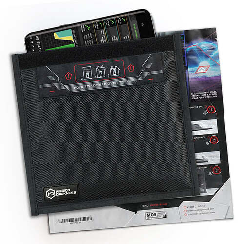

I personally have 2 mission darkness (laptop and phone) and they work well. Phone was unreachable in both bags)
Faraday bags are a bit of a scam imho. What do you need it for? If you need it for a phone you could use a pixel with GrapheneOS and airplane mode.
This is the best answer. I use mission darkness and have made my own with their bulk fabric. Buy direct, not through amazon/walmart middlemen. MD is great for returns and customer service. I’m a happy customer and use them in enviroments where malware infections via RF is possible.
