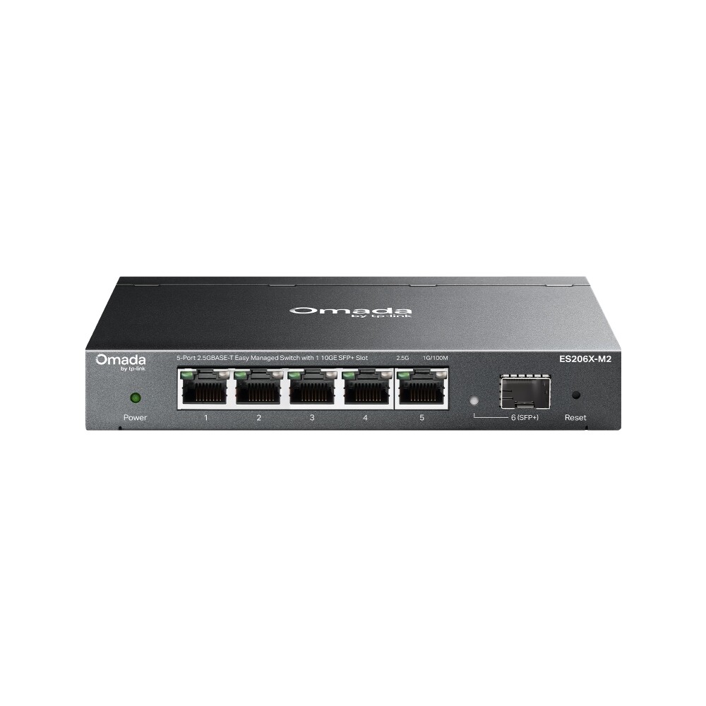

In general, can Omada switches be trusted? They have great specs and features.
