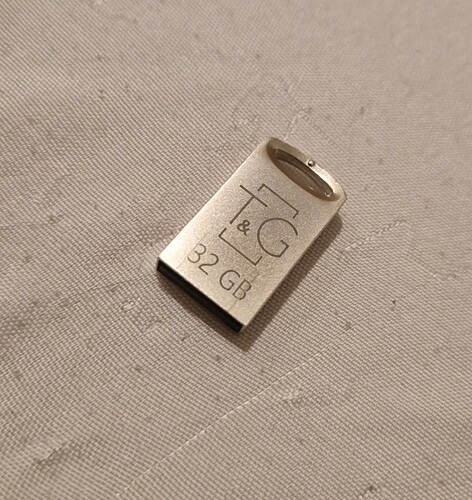

Four years ago I bought this one
It was super cheap. Like 5 bucks or something.

After creation, that flash NEVER touched again (no plugging in, no writes, no checks, no reads)
After 4 years I plugged it in USB port and checked hash again:
sha256sum video.mp4
903f401ab21cf105*********a467915280a85d7c70cbbcaed486******1928a video.mp4
As you can see file NOT corrupted.
