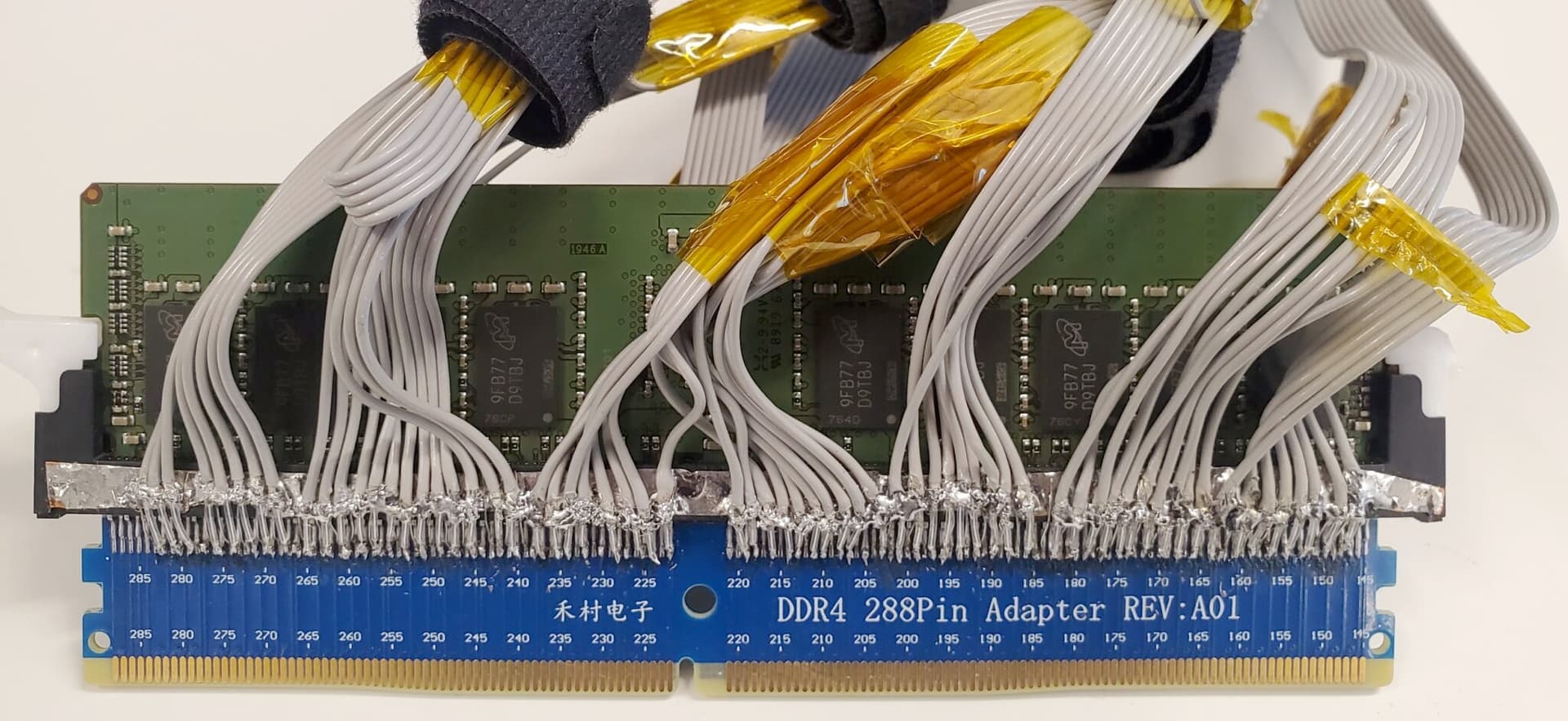

Over the years, researchers have repeatedly broken the security and privacy promises that Intel and AMD have made about their respective protections. On Tuesday, researchers independently published two papers laying out separate attacks that further demonstrate the limitations of SGX and SEV-SNP. One attack, dubbed Battering RAM, defeats both protections and allows attackers to not only view encrypted data but also to actively manipulate it to introduce software backdoors or to corrupt data. A separate attack known as Wiretap is able to passively decrypt sensitive data protected by SGX and remain invisible at all times.
Both attacks use a small piece of hardware, known as an interposer, that sits between CPU silicon and the memory module. Its position allows the interposer to observe data as it passes from one to the other. They exploit both Intel’s and AMD’s use of deterministic encryption, which produces the same ciphertext each time the same plaintext is encrypted with a given key. In SGX and SEV-SNP, that means the same plaintext written to the same memory address always produces the same ciphertext.
Deterministic encryption is well-suited for certain uses, such as full disk encryption, where the data being protected never changes once the thing being protected (in this case, the drive) falls into an attacker’s hands. The same encryption is suboptimal for protecting data flowing between a CPU and a memory chip because adversaries can observe the ciphertext each time the plaintext changes, opening the system to replay attacks and other well-known exploit techniques. Probabilistic encryption, by contrast, resists such attacks because the same plaintext can encrypt to a wide range of ciphertexts that are randomly chosen during the encryption process.
There isn’t an easy fix besides replacing deterministic encryption. Most likely, Intel and AMD will not dedicate resources towards mitigating these attacks.
For now, the only feasible solution is for chipmakers to replace deterministic encryption with a stronger form of protection. Given the challenges of making such encryption schemes scale to vast amounts of RAM, it’s not clear when that may happen.

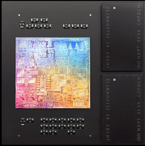

Thank you for the clear and succinct explanation of the exploits. Makes me wonder if ARM based processors like Apple Silicon or Qualcomm are inherently less vulnerable to this or if a lack of researcher attention has let similar issues go unnoticed.
I don’t think this is the case for mobile devices.
It would be much harder to do these on a running ARM system simply because the components are not modular. This:
…would be a challenge to do on Apple Silicon chips where the RAM is part of the package:
Even the attacks in this article do not work against DDR5, only DDR4, because DDR5 runs much faster. So, are ARM chips inherently less vulnerable? Yes. Is this completely impossible against ARM chips? I’m not sure.
I see your point.
